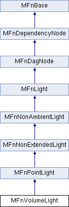

+ Inheritance diagram for MFnVolumeLight:
