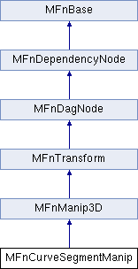

Inheritance diagram for MFnCurveSegmentManip:Public Member Functions | |
