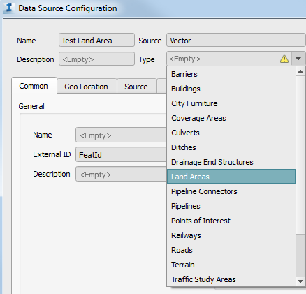

  2. Double-click the new data source in the Data Sources panel.
  3. Select Land Area as the Type in the Data Source Configuration dialogue box.
  4. Specify a Rule Style and Rule Grading if desired. This allows you to apply material, colour and grading styles to imported land areas using expressions, or by selecting styles from the Land Areas and Grading style catalogues. See To specify a Rule Style for more information.
