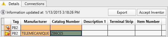

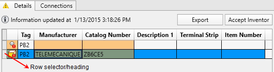

    • Click the row selector (heading) to select the entire row for your AutoCAD Electrical component.
    • Click on an individual cell
  7. Click Accept Inventor.
