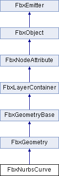

+ Inheritance diagram for FbxNurbsCurve:
