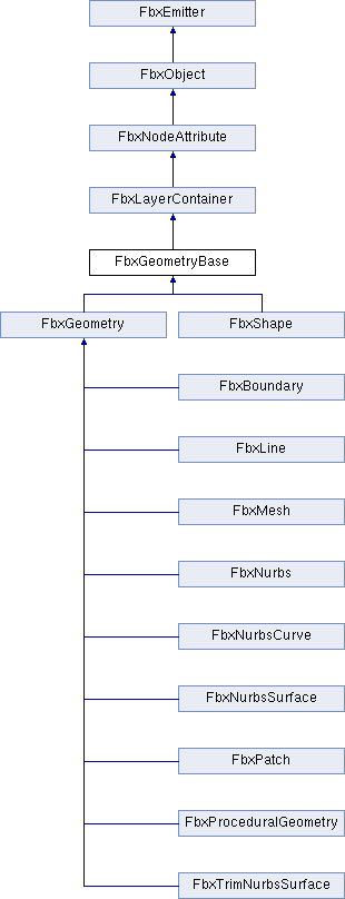

FbxGeometryBase Class Reference
#include <fbxgeometrybase.h>
Class Description
This class is the base class for geometric object such as meshes, NURBS and patches.
Use the FbxGeometryBase class to manage the control points, normals, binormals and tangents of the geometries. The meaning of "control point" is dependent of the geometry object type. For meshes, the "control point" is the physical 3D coordinate of polygon vertices while, for NURBS, it is the the actual control point on the curves defining the surface. This class also allow you to define normals, binormals and tangents regardless of the type of geometric object. However, in reality, applying such definitions to NURBS and patches does not make much sense since these definitions would only exist at the control points and inbetween them, the interpolation would certainly not follow the curve.
Geometric objects are using a system of layered data to extend their construction definition. For example, a typical layer for a Mesh contains Normals, UVs and Materials but client applications can decide to define another set of Normals and UVs and swap them during the rendering phase to produce some different results. The combinations are limitless and it would be impossible to discuss them all. This example has been presented to show one possible context where layers can be used. More information can be found in the FbxLayerContainer and FbxLayer classes description.
Definition at line 43 of file fbxgeometrybase.h.
+ Inheritance diagram for FbxGeometryBase:
