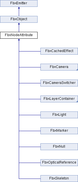

+ Inheritance diagram for FbxNodeAttribute:
