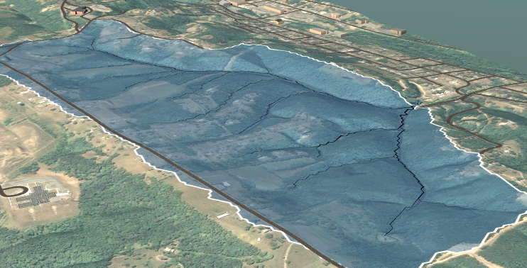

Use Drainage Design for InfraWorks 360 to model watersheds, culverts, and drainage networks. Review and analyze performance of individual drainage structures or sections of a drainage network. Choose pipes and connectors from a default or custom component part catalog, which Drainage Design can share with Autodesk AutoCAD Civil 3D.
Watersheds |
