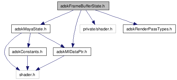

Include dependency graph for adskFrameBufferState.h:

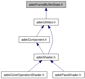

This graph shows which files directly or indirectly include this file:
