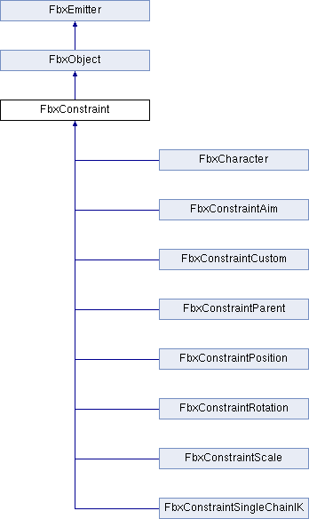

+ Inheritance diagram for FbxConstraint:
