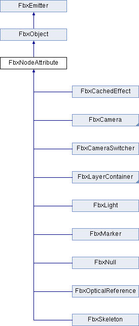

This class is the base class to all types of node attributes.
A node attribute is the content of a node. A NULL node attribute is set by calling function FbxNode::SetNodeAttribute() with a NULL pointer.

+ Inheritance diagram for FbxNodeAttribute:
