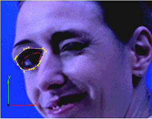

Warps are created by drawing a source spline, and then offsetting a second corresponding destination spline. When you draw a source spline, an identical destination spline is automatically created. When you move the destination spline, the offset of the destination from its source spline is what warps the clip. For example, you can draw a source spline around the eye of an actor, and then edit the points of the corresponding destination spline to make the eye bulge.
Source spline drawn around eye
