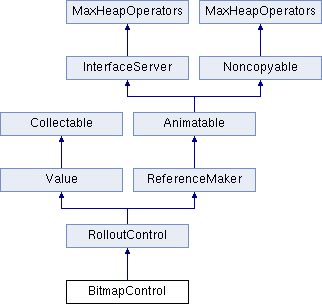

BitmapControl Class Reference
#include <rollouts.h>
+ Inheritance diagram for BitmapControl:
