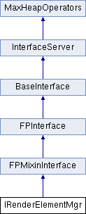

+ Inheritance diagram for IRenderElementMgr:
