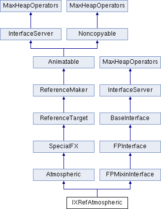

+ Inheritance diagram for IXRefAtmospheric:
