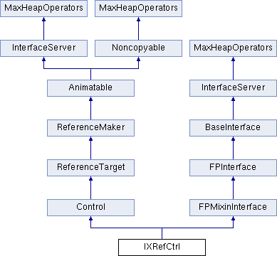

+ Inheritance diagram for IXRefCtrl:

anonymous enum
Enumerator
kfpGetSourceCtrl
kfpResetOffsetTM
69  {
72  };
Definition: iXrefCtrl.h:70
Definition: iXrefCtrl.h:71
