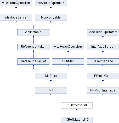

IXRefMaterial Class Reference
IXRefMaterial Class Referenceabstract
#include <iXrefMaterial.h>
Class Description
Class representing xref materials.
This interface groups functionality specific to xref materials. In order to access functionality common to all xref scene entities, use the IXRefItem interface. An xref material acts as a wrapper around the xrefed material (also referred to as the "source material"). For example, all shading methods on the XRef Material are automatically forwarded to the source material, requests for interfaces are also forwarded to the source material. Client or plugin code working with materials should not be required to write xref material specific code, unless the desired functionality is xref specific.
+ Inheritance diagram for IXRefMaterial:

Member Enumeration Documentation
anonymous enum
Enumerator
kfpGetSourceMaterial
68  {
70  };
Definition: iXrefMaterial.h:69
Member Function Documentation
virtual Mtl* GetSourceMaterial ( bool  resolveNestedXRef = false) const
pure virtual
Retrieves the source material, the actual material behind the XRef.
Parameters
[in]resolveNestedXRef- When set to true, the method will recursively resolve any nested XRef materials, guaranteeing that the material being returned is NOT an XRef material. When set to false, the source is returned directly without attempting to resolve nesting.
Returns
The source material, or NULL if the XRef is unresoled.
bool Is_IXRefMaterial ( Animatable animatable)
inlinestatic
Determines whether it is safe to cast an Animatable to an IXRefMaterial.
Parameters
[in]animatable- The animatable to test.
Returns
true if the specified animatable can be safely cast to IXRefMaterial, false otherwise.
81  {
82
83  return ((animatable.SuperClassID() == MATERIAL_CLASS_ID)
84  && (animatable.ClassID() == XREFMATERIAL_CLASS_ID));
85 }
virtual CoreExport Class_ID ClassID()
Retrieves a constant that uniquely identifies the plugin class.
#define XREFMATERIAL_CLASS_ID
XRef material class ID.
Definition: plugapi.h:548
#define MATERIAL_CLASS_ID
Materials super-class ID.
Definition: plugapi.h:389
virtual CoreExport SClass_ID SuperClassID()=0
Retrieves a constant representing the type of the plugin.
IXRefMaterial * GetInterface ( InterfaceServer is)
inlinestatic
Retrieves the IXRefMaterial interface from a scene entity.
Parameters
[in]is- Reference to scene entity
Returns
Pointer to the IXRefMaterial interface of the scene entity or NULL if it's not an xref material
87  {
88
89  return static_cast<IXRefMaterial*>(is.GetInterface(IID_XREF_MATERIAL));
90 };
#define IID_XREF_MATERIAL
Id for IXRefMaterial interface.
Definition: iXrefMaterial.h:18
virtual UtilExport BaseInterface * GetInterface(Interface_ID id)
Definition: iXrefMaterial.h:33
virtual FPInterfaceDesc* GetIXRefMaterialDesc ( )
pure virtual
Returns the function publishing descriptor for the XRef Material.
This method is need in order to avoid problems inherant to multiple inheritance.
Returns
The function publishing descriptor for the XRef Material.
Interface_ID GetID ( )
inlinevirtual
Remarks
This method overrides GetID() in those interfaces that do not publish metadata but instead have a unique Interface_ID for quick internal identification in implementation code that might be shared by a bunch of mixin interfaces.
Returns
The Interface_ID.
Default Implementation:
{ return GetDesc()->ID; }
Reimplemented from FPMixinInterface.
Reimplemented in IXRefMaterial18.
92  {
93
94  return IID_XREF_MATERIAL;
95 }
FPInterfaceDesc * GetDesc ( )
inlinevirtual
Remarks
Returns a pointer to the class which contains the interface metadata.
Implements FPInterface.
97  {
98
99  return GetIXRefMaterialDesc();
100 }
virtual FPInterfaceDesc * GetIXRefMaterialDesc()=0
