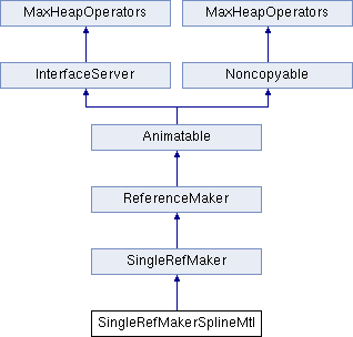

| | SingleRefMakerSplineMtl () |
| | ~SingleRefMakerSplineMtl () |
| RefResult | NotifyRefChanged (const Interval &changeInt, RefTargetHandle hTarget, PartID &partID, RefMessage message, BOOL propagate) |
| | By default handles REFMSG_TARGET_DELETED message only. More...
| virtual void | GetClassName (MSTR &s) |
| | Retrieves the (localizable) name of the plugin class. More...
| CoreExport | SingleRefMaker (AutoDropRefOnShutdown autoDropRefOnShutdown=Never) |
| | Constructor. More...
| CoreExport | SingleRefMaker (ReferenceTarget *refTarg, AutoDropRefOnShutdown autoDropRefOnShutdown=Never) |
| CoreExport | ~SingleRefMaker () |
| | Destructor. More...
| CoreExport void | SetRef (RefTargetHandle rt) |
| | Set the Reference. More...
| CoreExport RefTargetHandle | GetRef () const |
| | Get the Reference. More...
