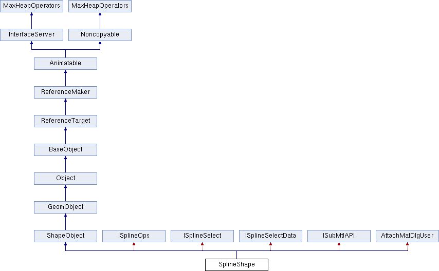

+ Inheritance diagram for SplineShape:

CoreExport int MakeCap (TimeValue t, PatchCapInfo &capInfo)
 This method creates a patch cap info out of the shape. More...
BezierShapeGetShape ()
CoreExport void DeleteThis ()
 Deletes an instance of this class. More...
void FreeCaches ()
virtual Class_ID ClassID ()
 Retrieves a constant that uniquely identifies the plugin class. More...
virtual CoreExport void GetClassName (MSTR &s)
 Retrieves the (localizable) name of the plugin class. More...
CoreExport voidGetInterface (ULONG id)
 Inherited from Animatable. More...
virtual CoreExport const MCHARGetObjectName ()
CoreExport int NumSubs ()
CoreExport AnimatableSubAnim (int i)
 This method returns the ShapeObject's animatable pointer. More...
CoreExport MSTR SubAnimName (int i)
 This method returns the name of the animatable's name. More...
CoreExport BOOL AssignController (Animatable *control, int subAnim)
int SubNumToRefNum (int subNum)
CoreExport BOOL SelectSubAnim (int subNum)
CoreExport void RescaleWorldUnits (float f)
 Implemented by the System. More...
CoreExport int RemapRefOnLoad (int iref)
 This method remaps references at load time so that files saved from previous versions of 3ds Max get their references adjusted properly to allow for the new ShapeObject reference. More...
CoreExport int NumRefs ()
 The ShapeObject makes 1 reference; this is where it tells the system. More...
CoreExport RefTargetHandle GetReference (int i)
 This method allows the ShapeObject to return a pointer to its parameter block. More...
CoreExport void CreateContArray ()
CoreExport void SynchContArray ()
CoreExport void AllocContArray (int count)
CoreExport void ReplaceContArray (Tab< Control * > &nc)
CoreExport void InsertPointConts (int index, int count)
CoreExport void DeletePointConts (BitArray &set)
CoreExport void ReversePointConts (int index, int count, BOOL keepFirst)
CoreExport void NullPointConts (int index, int count)
CoreExport void NullPolyPointConts (int poly)
CoreExport void PlugControllersSel (TimeValue t)
CoreExport BOOL PlugControl (TimeValue t, int i)
CoreExport void SetPtCont (int i, Control *c)
CoreExport void SetPointAnim (TimeValue t, int poly, int vert, Point3 pt)
CoreExport BOOL CloneVertCont (int from, int to)
CoreExport void SetRollupPage (IObjParam *ip, BOOL creating)
CoreExport void RemoveRollupPage (IObjParam *ip)
virtual CoreExport void BeginEditParams (IObjParam *ip, ULONG flags, Animatable *prev)
 This method allows the ShapeObject to create its new "Rendering" rollup. More...
virtual CoreExport void EndEditParams (IObjParam *ip, ULONG flags, Animatable *next)
 Similarly to BeginEditParams, this method allows the ShapeObject to remove its "Rendering" rollup. More...
CoreExport int GetSubobjectLevel ()
CoreExport void SetSubobjectLevel (int level)
CoreExport void ActivateSubobjSel (int level, XFormModes &modes)
 When the user changes the selection of the sub-object drop down, this method is called to notify the plug-in. More...
CoreExport void SelectSubComponent (HitRecord *hitRec, BOOL selected, BOOL all, BOOL invert)
 This method is called to change the selection state of the component identified by hitRec. More...
CoreExport void ClearSelection (int level)
 This method is called to clear the selection for the given sub-object level. More...
CoreExport void SelectAll (int level)
 This method is called to select every element of the given sub-object level. More...
CoreExport void InvertSelection (int level)
 This method is called to invert the specified sub-object level. More...
CoreExport void GetSubObjectCenters (SubObjAxisCallback *cb, TimeValue t, INode *node, ModContext *mc)
 When the user is in a sub-object selection level, the system needs to get the reference coordinate system definition from the current modifier being edited so that it can display the axis. More...
CoreExport void GetSubObjectTMs (SubObjAxisCallback *cb, TimeValue t, INode *node, ModContext *mc)
CoreExport void ShowEndResultChanged (BOOL showEndResult)
 This method notifies the BaseObject that the end result display has been switched (the "Show End Result" button has been toggled). More...
CoreExport int SubObjectIndex (HitRecord *hitRec)
 Returns the index of the sub-object element identified by the HitRecord hitRec. More...
CoreExport void MultiAttachObject (INodeTab &nodeTab)
CoreExport void BeginOutlineMove (TimeValue t)
CoreExport void BeginFilletMove (TimeValue t)
CoreExport void BeginChamferMove (TimeValue t)
CoreExport void OutlineMove (TimeValue t, float amount)
CoreExport void FilletMove (TimeValue t, float amount)
CoreExport void ChamferMove (TimeValue t, float amount)
CoreExport void EndMoveModes (TimeValue t, BOOL accept=TRUE)
CoreExport void EndOutlineMove (TimeValue t, BOOL accept=TRUE)
CoreExport void EndFilletMove (TimeValue t, BOOL accept=TRUE)
CoreExport void EndChamferMove (TimeValue t, BOOL accept=TRUE)
CoreExport void StartOutlineMode ()
CoreExport void StartFilletMode ()
CoreExport void StartChamferMode ()
CoreExport void DoOutline ()
CoreExport void DoFillet ()
CoreExport void DoChamfer ()
CoreExport void StartSegBreakMode ()
CoreExport void DoSegBreak (ViewExp *vpt, BezierShape *shape, int poly, int seg, IPoint2 p, INode *inode=NULL)
CoreExport void StartSegRefineMode ()
CoreExport void DoSegRefine (ViewExp *vpt, BezierShape *shape, int poly, int seg, IPoint2 p, INode *inode=NULL)
CoreExport void StartCrossInsertMode ()
CoreExport void DoCrossInsert (ViewExp *vpt, BezierShape *shape, int poly1, int seg1, int poly2, int seg2, IPoint2 p)
CoreExport void StartVertConnectMode ()
CoreExport void DoVertConnect (ViewExp *vpt, BezierShape *shape, int poly1, int vert1, int poly2, int vert2)
CoreExport void StartVertInsertMode (int controlID)
CoreExport int StartVertInsert (ViewExp *vpt, BezierShape *shape, int poly, int seg, int vert, INode *inode=NULL)
CoreExport void EndVertInsert (BOOL acceptUndo)
CoreExport void StartCreateLineMode ()
CoreExport BOOL StartCreateLine (BezierShape **shape)
CoreExport void EndCreateLine ()
CoreExport void StartCrossSectionMode ()
 this has the same effect as pressing the Cross Section button in the Spline's Geometry rollout More...
CoreExport void StartCrossSection ()
 should be used before a sequence of calls to DoCrossSection() More...
CoreExport void EndCrossSection (BOOL acceptUndo)
 should be used after a sequence of calls to DoCrossSection() More...
CoreExport BOOL BooleanStartUp ()
CoreExport void StartBooleanMode ()
CoreExport void DoBoolean (int poly2)
CoreExport void StartTrimMode ()
CoreExport void StartExtendMode ()
CoreExport void HandleTrimExtend (ViewExp *vpt, ShapeHitData *hit, IPoint2 &m, int operation)
CoreExport int GetAttachMat ()
CoreExport void SetAttachMat (int value)
CoreExport BOOL GetCondenseMat ()
CoreExport void SetCondenseMat (BOOL sw)
CoreExport int DoAttach (INode *node, bool &canUndo)
CoreExport void DoCrossSection (Tab< int > &splineIndices)
 creates a cross section of the current selected spline or segement with the given spline(s). More...
CoreExport void DoVertBreak ()
CoreExport void DoVertWeld ()
CoreExport void DoMakeFirst ()
CoreExport void DoVertDelete ()
CoreExport void DoSegDelete ()
CoreExport void DoSegDetach (int sameShape, int copy, int reorient)
CoreExport void DoSegDivide (int divisions)
CoreExport void DoPolyClose ()
CoreExport void DoPolyDetach (int copy, int reorient)
CoreExport void DoPolyMirror (int type, int copy)
CoreExport void DoPolyDelete ()
CoreExport void DoPolyReverse ()
CoreExport void DoPolyExplode ()
CoreExport void DoExplodeToObjects ()
CoreExport void SetBoolOperation (int type)
CoreExport void SetMirrorOperation (int type)
CoreExport int GetBoolOperation ()
CoreExport int GetMirrorOperation ()
CoreExport UI::MouseCursors::ECursors GetBoolCursorID ()
CoreExport int GetBoolMirrString (UINT_PTR type)
CoreExport void SetBooleanButton ()
CoreExport void SetMirrorButton ()
CoreExport void ChangeSelVerts (int type)
CoreExport void ChangeRememberedVert (int type)
CoreExport int RememberVertThere (HWND hWnd, IPoint2 m)
CoreExport void SetRememberedVertType (int type)
CoreExport void ChangeSelSegs (int type)
CoreExport void ChangeRememberedSeg (int type)
CoreExport int RememberSegThere (HWND hWnd, IPoint2 m)
CoreExport void SetRememberedSegType (int type)
CoreExport void ChangeSelPolys (int type)
CoreExport void ChangeRememberedPoly (int type)
CoreExport int RememberPolyThere (HWND hWnd, IPoint2 m)
CoreExport void SetRememberedPolyType (int type)
CoreExport void SplineShapeClone (SplineShape *source)
CoreExport int GetPointIndex (const Tab< Point3 > &vertList, const Point3 &point) const
 this simply performs a linear search through the given list, returning the index of the given point More...
CoreExport void DeleteSpline (int poly)
CoreExport void InsertSpline (Spline3D *spline, int poly)
CoreExport void Reverse (int poly, BOOL keepFirst=FALSE)
CoreExport void DeleteKnot (int poly, int index)
CoreExport void AddKnot (int poly, SplineKnot &k, int where=-1)
CoreExport BOOL Append (int poly, Spline3D *spline, BOOL weldCoincidentFirstVertex=TRUE)
CoreExport BOOL Prepend (int poly, Spline3D *spline, BOOL weldCoincidentLastVertex=TRUE)
CoreExport void ReplaceSpline (int poly, Spline3D *spline)
CoreExport BOOL DeleteSelVerts (int poly)
CoreExport BOOL DeleteSelSegs (int poly)
CoreExport void MakeFirst (int poly, int index)
CoreExport void SetOptimize (BOOL sw)
CoreExport void SetAdaptive (BOOL sw)
CoreExport void SetSteps (int n)
CoreExport void RecordTopologyTags ()
CoreExport void ResolveTopoChanges (BezierShape *shape=NULL, int bindTrackingOptions=1)
CoreExport void RefreshSelType ()
CoreExport void UpdateSelectDisplay ()
CoreExport void SetSelDlgEnables ()
CoreExport void SetOpsDlgEnables ()
CoreExport void SetSurfDlgEnables ()
CoreExport void SetSoftSelDlgEnables (HWND hSoftSel=NULL)
CoreExport void SelectionChanged ()
CoreExport BOOL MaybeSelectSingleSpline (BOOL makeUndo=FALSE)
CoreExport void SetFCLimit ()
CoreExport int GetSelMatIndex ()
CoreExport void SetSelMatIndex (int index)
CoreExport void SelectByMat (int index, BOOL clear)
CoreExport void InvalidateSurfaceUI ()
CoreExport IOResult Save (ISave *isave)
CoreExport IOResult Load (ILoad *iload)
CoreExport void StartBindMode ()
CoreExport void DoBind (int poly1, int vert1, int poly2, int vert2)
CoreExport void DoUnBind ()
CoreExport void DoHide ()
CoreExport void DoUnhide ()
CoreExport void DoCycleVerts ()
CoreExport void StartRefineConnectMode ()
CoreExport void EndRefineConnectMode ()
CoreExport void DoRefineConnect (ViewExp *vpt, BezierShape *shape, int poly, int seg, IPoint2 p, INode *inode=NULL)
CoreExport void DoVertFuse ()
CoreExport void StartCopyTangentMode ()
 this has the same effect as pressing the Copy button in the "Tangent" section of the Spline UI, when in Vertex sub-object mode More...
CoreExport void StartPasteTangentMode ()
 this has the same effect as pressing the Paste button in the "Tangent" section of the Spline UI, when in Vertex sub-object mode More...
CoreExport void StartPasteTangent ()
 should be used before a call to PasteTangent() More...
CoreExport void EndPasteTangent ()
 should be used following a call to PasteTangent() More...
CoreExport BOOL CopyTangent (int poly, int vert)
 copy the given tangent More...
CoreExport BOOL PasteTangent (int poly, int vert)
 paste the given tangent. More...
CoreExport void StartCommandMode (splineCommandMode mode)
CoreExport void ButtonOp (splineButtonOp opcode)
CoreExport void GetUIParam (splineUIParam uiCode, int &ret)
CoreExport void SetUIParam (splineUIParam uiCode, int val)
CoreExport void GetUIParam (splineUIParam uiCode, float &ret)
CoreExport void SetUIParam (splineUIParam uiCode, float val)
bool Editing ()
CoreExport DWORD GetSelLevel ()
CoreExport void SetSelLevel (DWORD level)
CoreExport void LocalDataChanged ()
CoreExport BitArray GetVertSel ()
CoreExport BitArray GetSegmentSel ()
CoreExport BitArray GetSplineSel ()
CoreExport void SelectBySegment (BOOL interactive=TRUE)
CoreExport void SelectBySpline (BOOL interactive=TRUE)
CoreExport void SetVertSel (BitArray &set, ISplineSelect *imod, TimeValue t)
CoreExport void SetSegmentSel (BitArray &set, ISplineSelect *imod, TimeValue t)
CoreExport void SetSplineSel (BitArray &set, ISplineSelect *imod, TimeValue t)
CoreExport GenericNamedSelSetListGetNamedVertSelList ()
CoreExport GenericNamedSelSetListGetNamedSegmentSelList ()
CoreExport GenericNamedSelSetListGetNamedSplineSelList ()
CoreExport MtlID GetNextAvailMtlID (ModContext *mc)
CoreExport BOOL HasFaceSelection (ModContext *mc)
CoreExport void SetSelFaceMtlID (ModContext *mc, MtlID id, BOOL bResetUnsel=FALSE)
CoreExport int GetSelFaceUniqueMtlID (ModContext *mc)
CoreExport int GetSelFaceAnyMtlID (ModContext *mc)
CoreExport int GetMaxMtlID (ModContext *mc)
CoreExport void InvalidateGeomCache ()
 This method is very important - It causes the ShapeObject to flush its cached rendering mesh. More...
CoreExport int UseEdgeDists ()
CoreExport void SetUseEdgeDists (int useSoftSelections)
CoreExport int UseSoftSelections ()
CoreExport void SetUseSoftSelections (int useSoftSelections)
CoreExport void InvalidateVertexWeights ()
CoreExport void UpdateVertexDists ()
CoreExport void UpdateEdgeDists ()
CoreExport void UpdateVertexWeights ()
- Public Member Functions inherited from ShapeObject
CoreExport ShapeObject ()
CoreExport ~ShapeObject ()
virtual CoreExport BaseInterfaceGetInterface (Interface_ID iid)
