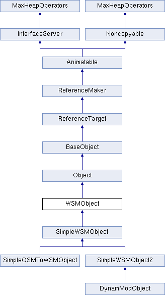

Class Object, Class SimpleWSMObject, Class ForceField, Class CollisionObject
+ Inheritance diagram for WSMObject:
