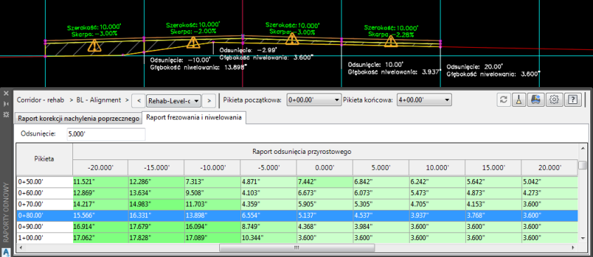

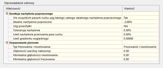

When creating a rehab corridor, you specify parameters for cross slope correction, mill, level, and overlay, and AutoCAD Civil 3D builds the assembly and the corridor to meet your specified criteria. For more information, see About Rehab Corridor Modeling.
Based on the parameters you specify when creating a rehab corridor, the assembly for the corridor is built automatically using the following subassemblies:
For information about these subassemblies, including how to import them, see Rehab and Cross Slope Optimization Subassemblies.
You can use the Rehab Manager to generate Cross Slope Correction and Milling and Leveling reports for selected stations within rehab corridor regions. You can make changes to values in the reports, and apply the changes back to the rehab corridor. For more information, see To Generate Rehab Corridor Reports.

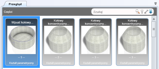

Use the Infrastructure Parts Editor to customize drainage structure or piping part families and part assemblies, then publish them to catalogs to use in AutoCAD Civil 3D. For more information, see About the Parts Editor and To Open the Parts Editor.

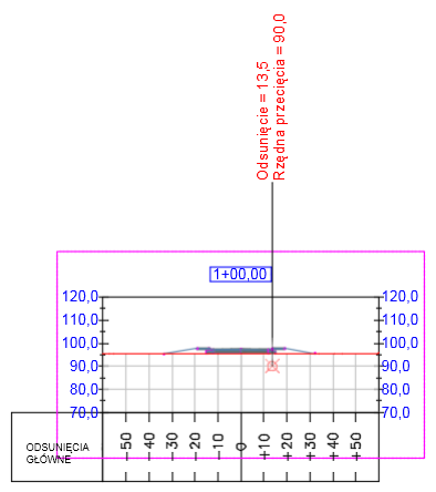

You can display and label the locations where objects cross a sample line using options that are specifically for crossings. For more information, see About Working With Projections and Crossings in Section Views.

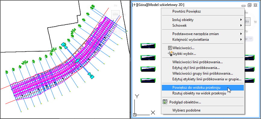

When projecting objects to multiple section views, you can use options for filtering the selection of objects by layer, style, and point group. For more information, see To Project Objects to Multiple Section Views.
Use new navigation options to zoom to a section view from a sample line, and to zoom to a sample line from a section view. For more information, see To Navigate Between Sample Lines and Section Views.

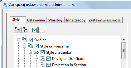

You can use the new Manage Referenced Settings dialog box to control which individual components are referenced. For more information, see Manage Referenced Settings Dialog Box.

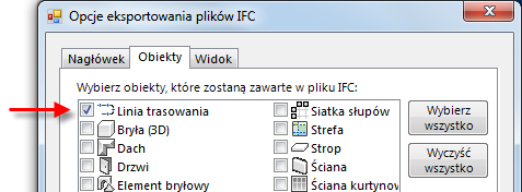

Export and import alignments and their associated finished ground profile data using IFC version 4x1. For more information, see To Specify Industry Foundation Class (IFC) Export Options and To Import Industry Foundation Class (IFC) Files.
