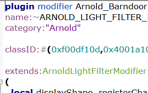

Scripted Plug-ins:

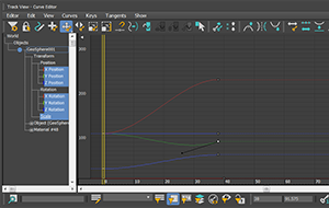

TrackView:

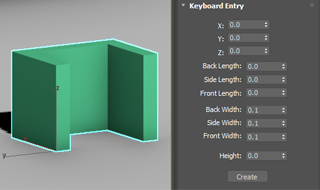

Geometry Objects Type-in Properties:

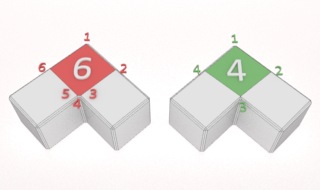

Chamfer Quad Intersection Mode: The following boolean properties have been added to control the quad intersection mode. Enabling this mode attempts to preserve the quad structure of the faces participating in the chamfered edges.
