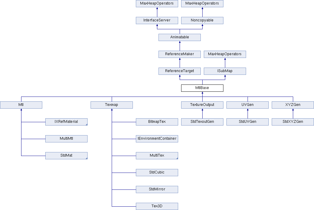

+ Inheritance diagram for MtlBase:

Remarks
Constructor. The flags and G-buffer id are initialized.
Member Function Documentation
