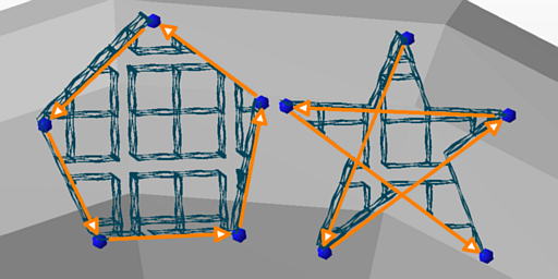

Left-click to place anchors at corner points along the circumference of the desired volume support.
Note: You should avoid zig-zagging when you set anchors unless you are certain of Netfabb's behavior. Otherwise, this may lead to unexpected support contours as Netfabb connects anchors in the order of their placement and then fills only the enclosed area:
Left: a 5-point volume support, its contour defined by placing only nearest neighbors of anchors. Right: The same five points, but defined in a different order.
