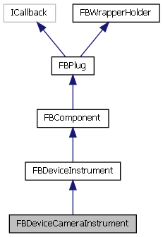

Inheritance diagram for FBDeviceCameraInstrument:

Detailed Description
Instrument for a camera device.
This instrument provides the necessary parameters to provide camera tracking support in a device driver (the FBDeviceCamera class and its derivatives). This will also provide a management system for lens look-up tables. Lens tables are used in order to interpret linear encoder values with the non- linear changes in the actual lens.
Definition at line 227 of file fbtracker.h.
