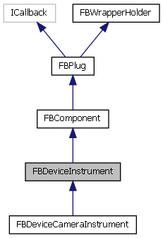

Inheritance diagram for FBDeviceInstrument:
