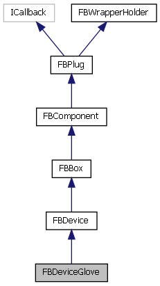

Base Glove class. More...
#include <fbcore.h>
