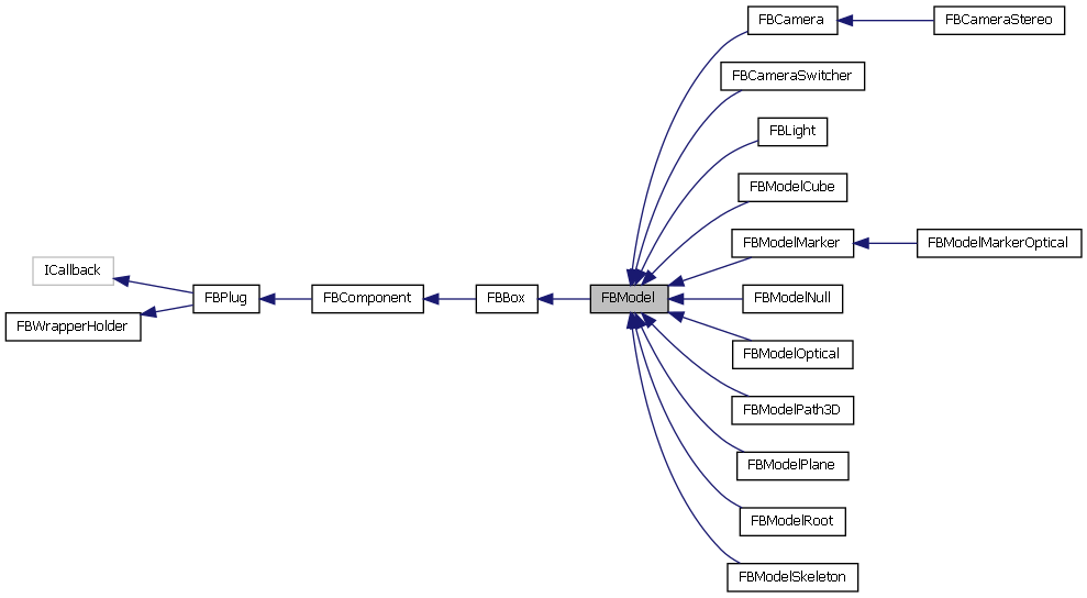

Inheritance diagram for FBModel:

Detailed Description
Model class.
In the MotionBuilder UI, a model can be any object in a scene, created using geometry. Models can represent simple objects like cubes, or complex objects like characters.
FBModel is a base class which is not used so much directly, but is the parent of well-used classes like FBCamera, FBLight, and FBModelMarker.
It also implements a number of widely-implemented functions and attributes, such as:
  • Clone(), FBDelete()
  • UI attributes such as Show, Pickable, and Visibility
  • Positional attributes such as Rotation, Scaling, and Translation The following Python snippet shows how to create, show, rotate, and delete a cube
    from pyfbsdk import *
    myCube = FBModelCube("cube")
    myCube.Show = True
    myCube.Rotation = FBVector3d(45, 45, 45)
    myCube.FBDelete()
There is a few ways to get a handle on existing models in a scene:
