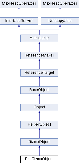

#include <gizmoimp.h>
Public Member Functions | |
CoreExport | BoxGizmoObject () |
CoreExport | ~BoxGizmoObject () |
CoreExport CreateMouseCallBack * | GetCreateMouseCallBack () |
This method allows the system to retrieve a callback object used in creating an object in the 3D viewports. More... | |
CoreExport void | BeginEditParams (IObjParam *ip, ULONG flags, Animatable *prev) |
CoreExport void | EndEditParams (IObjParam *ip, ULONG flags, Animatable *next) |
CoreExport const MCHAR * | GetObjectName () |
CoreExport void | InitNodeName (MSTR &s) |
Implemented by the System. More... | |
CoreExport void | GetClassName (MSTR &s) |
Retrieves the (localizable) name of the plugin class. More... | |
CoreExport void | DeleteThis () |
Deletes an instance of this class. More... | |
Class_ID | ClassID () |
Retrieves a constant that uniquely identifies the plugin class. More... | |
CoreExport RefTargetHandle | Clone (RemapDir &remap) |
This method is used by 3ds Max to clone an object. More... | |
Interval | ObjectValidity (TimeValue t) |
CoreExport void | InvalidateUI () |
CoreExport ParamDimension * | GetParameterDim (int pbIndex) |
CoreExport MSTR | GetParameterName (int pbIndex) |
CoreExport void | DrawGizmo (TimeValue t, GraphicsWindow *gw) |
CoreExport void | GetBoundBox (Matrix3 &mat, TimeValue t, Box3 &box) |
CoreExport | GizmoObject () |
CoreExport | ~GizmoObject () |
CoreExport int | HitTest (TimeValue t, INode *inode, int type, int crossing, int flags, IPoint2 *p, ViewExp *vpt) |
This method is called to determine if the specified screen point intersects the item. More... | |
CoreExport int | Display (TimeValue t, INode *inode, ViewExp *vpt, int flags) |
This is called by the system to have the item display itself (perform a quick render in viewport, using the current TM). More... | |
ObjectState | Eval (TimeValue time) |
This method is called to evaluate the object and return the result as an ObjectState. More... | |
CoreExport int | CanConvertToType (Class_ID obtype) |
Indicates whether the object can be converted to the specified type. More... | |
CoreExport Object * | ConvertToType (TimeValue t, Class_ID obtype) |
This method converts this object to the type specified and returns a pointer it. More... | |
CoreExport void | GetWorldBoundBox (TimeValue t, INode *inode, ViewExp *vpt, Box3 &box) |
This method returns the world space bounding box for Objects (see below for the Sub-object gizmo or Modifiers gizmo version). More... | |
CoreExport void | GetLocalBoundBox (TimeValue t, INode *inode, ViewExp *vpt, Box3 &box) |
This is the object space bounding box, the box in the object's local coordinates. More... | |
CoreExport void | GetDeformBBox (TimeValue t, Box3 &box, Matrix3 *tm, BOOL useSel) |
This method computes the bounding box in the objects local coordinates or the optional space defined by tm. More... | |
int | NumSubs () |
Animatable * | SubAnim (int i) |
MSTR | SubAnimName (int i) |
int | NumRefs () |
Returns the total number of references this ReferenceMaker can hold. More... | |
RefTargetHandle | GetReference (int i) |
Returns the 'i-th' reference. More... | |
CoreExport RefResult | NotifyRefChanged (const Interval &changeInt, RefTargetHandle hTarget, PartID &partID, RefMessage message, BOOL propagate) |
Receives and responds to messages. More... | |
virtual Point3 | WireColor () |
SClass_ID | SuperClassID () |
int | IsRenderable () |
virtual int | UsesWireColor () |
virtual BOOL | NormalAlignVector (TimeValue t, Point3 &pt, Point3 &norm) |
Objects that don't support the IntersectRay() method (such as helper objects) can implement this method to provide a default vector for use with the normal align command in 3ds Max. More... | |
CoreExport | Object () |
CoreExport | ~Object () |
virtual int | DoOwnSelectHilite () |
If an object wants to draw itself in the 3D viewports in its selected state in some custom manner this method should return nonzero. More... | |
virtual int | IntersectRay (TimeValue t, Ray &r, float &at, Point3 &norm) |
This method is called to compute the intersection point and surface normal at this intersection point of the ray passed and the object. More... | |
void | LockObject () |
void | UnlockObject () |
int | IsObjectLocked () |
void | LockChannels (ChannelMask channels) |
void | UnlockChannels (ChannelMask channels) |
ChannelMask | GetChannelLocks () |
void | SetChannelLocks (ChannelMask channels) |
ChannelMask | GetChannelLocks (ChannelMask m) |
virtual BOOL | CanCacheObject () |
This method determines if this object can have channels cached. More... | |
virtual void | WSStateInvalidate () |
This is called by a node when the node's world space state has become invalid. More... | |
virtual BOOL | IsWorldSpaceObject () |
Returns TRUE if the object as a world space object; otherwise FALSE. More... | |
CoreExport INode * | GetWorldSpaceObjectNode () |
virtual BOOL | IsParticleSystem () |
CoreExport void | CopyChannelLocks (Object *obj, ChannelMask needChannels) |
virtual void | TopologyChanged () |
virtual int | IsDeformable () |
Indicates whether this object is deformable. More... | |
virtual int | NumPoints () |
The points of a deformable object are accessed through a virtual array interface. More... | |
virtual Point3 | GetPoint (int i) |
virtual void | SetPoint (int i, const Point3 &p) |
virtual BOOL | IsPointSelected (int i) |
Returns TRUE if the 'i-th' point is selected; otherwise FALSE. More... | |
virtual float | PointSelection (int i) |
Returns a floating point weighted point selection if the object supports it. More... | |
virtual BOOL | HasWeights () |
Returns TRUE if the object has weights for its points that can be set; otherwise FALSE. More... | |
virtual double | GetWeight (int i) |
Returns the weight of the specified point of the object. More... | |
virtual void | SetWeight (int i, const double w) |
Sets the weight of the specified point. More... | |
virtual BOOL | PolygonCount (TimeValue t, int &numFaces, int &numVerts) |
Retreives the number of faces and vertices of the polyginal mesh representation of this object. More... | |
virtual void | PointsWereChanged () |
Informs the object that its points have been deformed, so it can invalidate its cache. More... | |
virtual CoreExport void | Deform (Deformer *defProc, int useSel=0) |
This is the method used to deform the object with a deformer. More... | |
virtual int | IsMappable () |
This method lets you know if the ApplyUVWMap() method is available for this object. More... | |
virtual int | NumMapChannels () |
Returns the maximum number of channels supported by this type of object. More... | |
virtual int | NumMapsUsed () |
Returns the number of maps currently used by this object. More... | |
virtual void | ApplyUVWMap (int type, float utile, float vtile, float wtile, int uflip, int vflip, int wflip, int cap, const Matrix3 &tm, int channel=1) |
This method may be called to map the object with UVW mapping coordinates. More... | |
virtual Class_ID | PreferredCollapseType () |
This method allows objects to specify the class that is the best class to convert to when the user collapses the stack. More... | |
virtual CoreExport void | GetCollapseTypes (Tab< Class_ID > &clist, Tab< MSTR * > &nlist) |
When the user clicks on the Edit Stack button in the modify branch a list of 'Convert To:' types is presented. More... | |
virtual Object * | CollapseObject () |
This method is called on the world space cache object when the stack gets collapsed, that lets the pipeline object decide, if it wants to return a different object than itself. More... | |
virtual DWORD | GetSubselState () |
For objects that have sub selection levels, this method returns the current selection level of the object. More... | |
virtual void | SetSubSelState (DWORD s) |
CoreExport void | ReadyChannelsForMod (ChannelMask channels) |
virtual CoreExport Interval | ChannelValidity (TimeValue t, int nchan) |
Retrieve the current validity interval for the nchan channel of the object. More... | |
virtual CoreExport void | SetChannelValidity (int nchan, Interval v) |
Sets the validity interval of the specified channel. More... | |
virtual CoreExport void | InvalidateChannels (ChannelMask channels) |
This method invalidates the intervals for the given channel mask. More... | |
virtual Object * | MakeShallowCopy (ChannelMask channels) |
This method must make a copy of its "shell" and then shallow copy (see below) only the specified channels. More... | |
virtual CoreExport void | ShallowCopy (Object *fromOb, ChannelMask channels) |
This method copies the specified channels from the fromOb to this and copies the validity intervals. More... | |
virtual CoreExport void | FreeChannels (ChannelMask channels) |
This method deletes the memory associated with the specified channels and set the intervals associated with the channels to invalid (empty). More... | |
virtual CoreExport void | NewAndCopyChannels (ChannelMask channels) |
This method replaces the locked channels with newly allocated copies. More... | |
virtual CoreExport void | MaybeEnlargeViewportRect (GraphicsWindow *gw, Rect &rect) |
This method allows the object to enlarge its viewport rectangle, if it wants to. More... | |
CoreExport bool | IsBaseClassOwnedChannel (int nchan) |
CoreExport void | UpdateValidity (int nchan, Interval v) |
When a modifier is applied to an object, it needs to include its own validity interval in the interval of the object. More... | |
Interval | GetNoEvalInterval () |
void | SetNoEvalInterval (Interval iv) |
virtual CoreExport void | ReduceCaches (TimeValue t) |
This method give the object the chance to reduce its caches. More... | |
virtual int | IsConstObject () |
This is called to determine if this is a construction object or not. More... | |
virtual int | NumPipeBranches (bool selected=true) |
This method returns the number of pipeline branches combined by the object. More... | |
virtual Object * | GetPipeBranch (int i, bool selected=true) |
Retrieves sub-object branches from an object that supports branching. More... | |
virtual INode * | GetBranchINode (TimeValue t, INode *node, int i, bool selected=true) |
When an object has sub-object branches, it is likely that the sub-objects are transformed relative to the object. More... | |
virtual int | NumberOfContainedShapes () |
Returns the number of shapes contained inside this object. More... | |
virtual ShapeObject * | GetContainedShape (TimeValue t, int index) |
This method returns the ShapeObject specified by the index passed at the time specified. More... | |
virtual void | GetContainedShapeMatrix (TimeValue t, int index, Matrix3 &mat) |
Returns the matrix associated with the shape whose index is passed. More... | |
