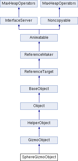

#include <gizmoimp.h>
 Inheritance diagram for SphereGizmoObject:
 Inheritance diagram for SphereGizmoObject:| Public Member Functions | |
