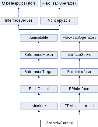

+ Inheritance diagram for ISplineIKControl:
