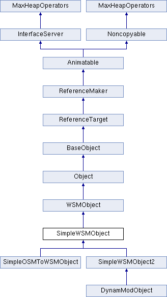

Space warp object plug-ins which subclass off SimpleWSMObject must implement these methods. The default implementations are noted.
+ Inheritance diagram for SimpleWSMObject:

Public Attributes
IParamBlockpblock
Mesh mesh
Interval ivalid
Static Public Attributes

AnimPropertyList aprops
Member Function Documentation
CoreExport void UpdateMesh ( TimeValue  t)
CoreExport void GetBBox ( TimeValue  t,
Matrix3 tm,
Box3 box
void MeshInvalid ( )
inline
310 {ivalid.SetEmpty();}
Interval ivalid
Definition: simpobj.h:301
void SetEmpty()
Definition: interval.h:126
