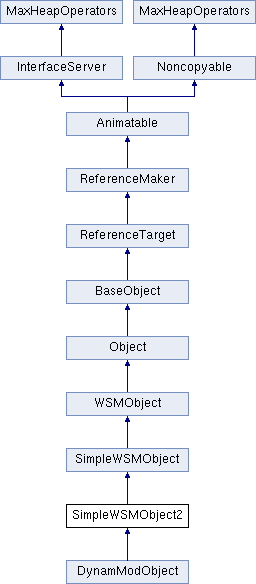

SimpleWSMObject2 Class Reference
#include <simpobj.h>
+ Inheritance diagram for SimpleWSMObject2:
