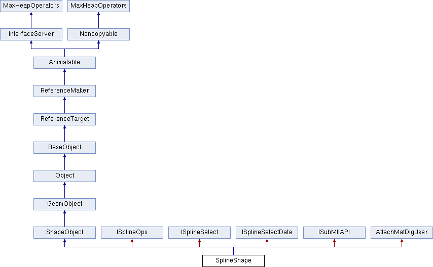

 Inheritance diagram for SplineShape:
 Inheritance diagram for SplineShape:| Public Member Functions | |
