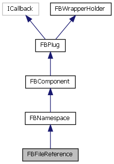

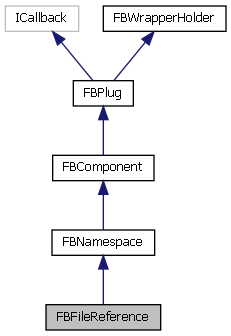

Inheritance diagram for FBFileReference:

Detailed Description
Objects Containing class.
This class is an interface to manipulate object's containing in the scene.
Definition at line 86 of file fbfilereference.h.
