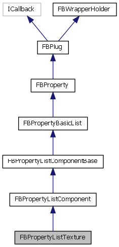

PropertyList: Texture More...
#include <fbtexture.h>
Public Member Functions | |
| virtual int | Add (FBTexture *pItem) |
| Add a texture to the property list. More... | |
| FBTexture * | operator[] (int pIndex) |
| Get the texture at a specific index. More... | |
Definition at line 158 of file fbtexture.h.
virtual |
| pItem | Texture to add to the list. |
| FBTexture* operator[] | ( | int | pIndex | ) |
| pIndex | Index of texture to get. |
