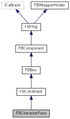

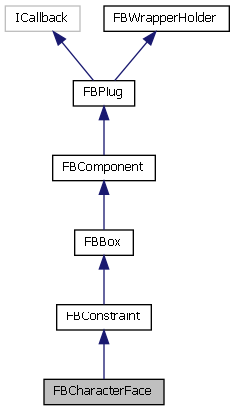

Inheritance diagram for FBCharacterFace:
