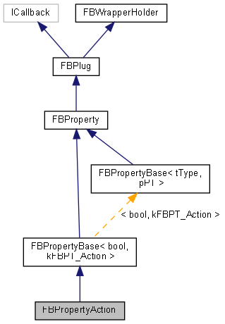

Inheritance diagram for FBPropertyAction:

Detailed Description
Property: Action Action property to trigger function.
Definition at line 1313 of file fbproperties.h.
