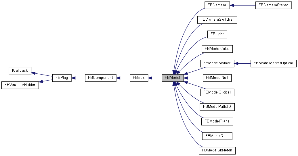

Inheritance diagram for FBModel:

Detailed Description
Model class.
In the MotionBuilder UI, a model can be any object in a scene, created using geometry. Models can represent simple objects like cubes, or complex objects like characters.
FBModel is a base class which is not used so much directly, but is the parent of well-used classes like FBCamera, FBLight, and FBModelMarker.
It also implements a number of widely-implemented functions and attributes, such as:
There is a few ways to get a handle on existing models in a scene:
  • FBFindObjectsByName return a list of objects matching a pattern (can contain *). For usage, see: FindObjectsWithWildcard.py
