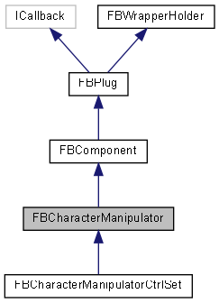

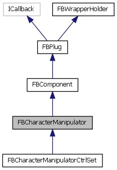

Inheritance diagram for FBCharacterManipulator:

Detailed Description
Character Manipulator class.
Definition at line 165 of file fbcharactermanipulator.h.
