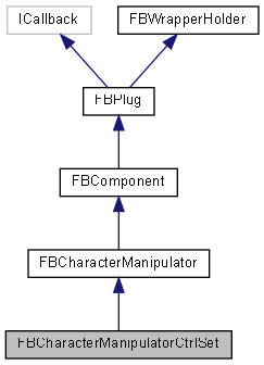

Inheritance diagram for FBCharacterManipulatorCtrlSet:
