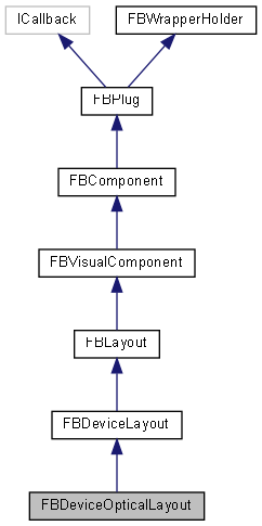

Inheritance diagram for FBDeviceOpticalLayout:
