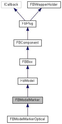

Inheritance diagram for FBModelMarker:

Detailed Description
Model marker class.
Definition at line 872 of file fbmodel.h.
