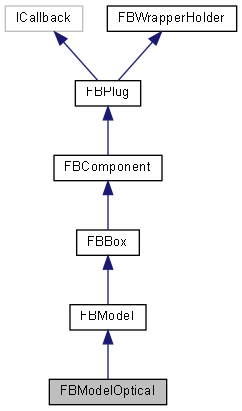

Optical model class. More...
#include <fboptical.h>
