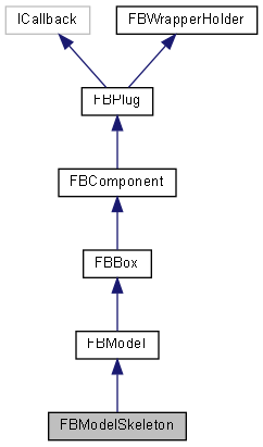

| | FBModelSkeleton (const char *pName, HIObject pObject=NULL) |
| | Constructor. More...
| void | GetSkinModelList (FBModelList &pSkinModelList) |
