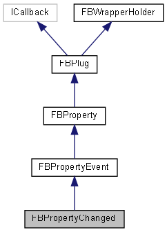

Inheritance diagram for FBPropertyChanged:
