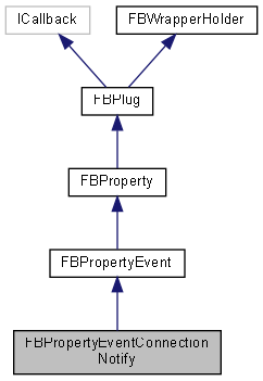

Inheritance diagram for FBPropertyEventConnectionNotify:
