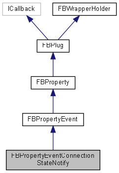

Inheritance diagram for FBPropertyEventConnectionStateNotify:
