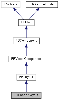

Inheritance diagram for FBShaderLayout:

Detailed Description
Shader layout class.
Definition at line 106 of file fbshaderlayout.h.
◆ FBShaderLayout()
FBShaderLayout ( FBShader pShader = NULL)
Constructor.
Parameters
pShaderShader to association with Shader layout.
Member Data Documentation
◆ Shader
FBPropertyShader Shader
Property : Shader.
Definition at line 116 of file fbshaderlayout.h.
