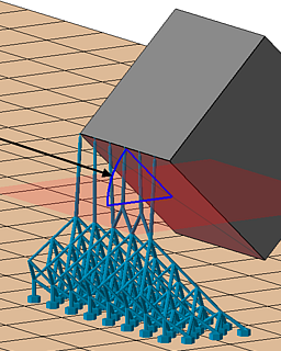

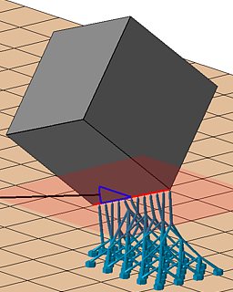

Minimal, Maximal area above part |
A detected cluster's down-projected area must only be intruded into by other mesh (same or different part) to a fraction specified by this range, or it is disregarded for the respective support action. |
0-100 % |

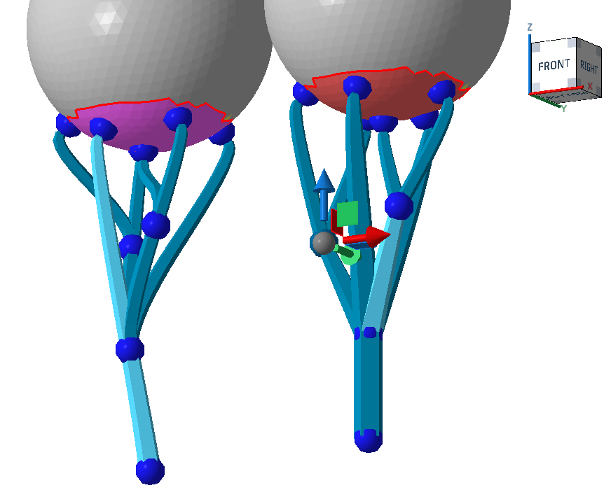

Bouquet-structure type |
Netfabb knows two methods to bundle bar supports together. The classical one picks one main bar and grows additional bars from it or from other bars that originate on the main bar themselves ("side branching"). The other, newer method uses proper iterative splitting of bars into ever thinner ones to ultimately cover the cluster's entire surface area with supports ("split branching"). Side branching
Split branching
![]() Side branching (left) and split branching (right). Note how the selected one on the left goes all the way from the part surface to the bottom, and how other beams "sprout" from it, whereas on the right, the branches split evenly. |

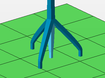

Root system |
When active, the bottom of the bars are multiplied to form a tree-root-like structure that reinforces the adherence of individual bars. |
Number of legs |
![]() The count of legs includes the center one. |
Height |
At this height above the platform or the bottom part surface, measured along the center leg, the side legs merge with the main bar. |
Diameter |
The side bars terminate at a circular contour of this diameter parallel to the build platform. If the bars meet a suitable surface before or beyond this imaginary circle, such as when they terminate on an uneven part surface, the bars are shortened or extended appropriately to maintain the side bar angle. |

| Neighbor area angle |
Specify a "critical angle" for the surface that itself is not critical but terminates in an edge you still want to have supported. |
